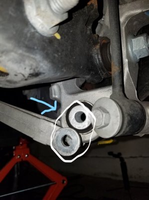

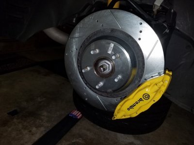

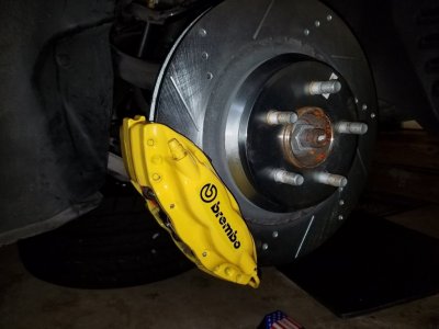

    I completed my rotor and brake swap.. For the rears you must remove the 18mm bolt from the control arm as the control arm blocks access to the bottom caliper bolt. ( use a vice grip to hold the nut on the opposite side)
    Blue arrow = caliper bolt location
    White ink = control arm bolt location
