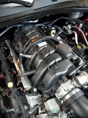

    Now, I am not near my wife's Charger because I am working in Joliet, IL,
    but it looks from photos as if the PCV vent line goes into the intake AFTER the throttle body on the 6.4L.
    On the 5.7 it's no where near the throttle body
    Do you mean the line is not near the throttle body on the 5.7 chargers?
    cause on my 5.7 RAM it plugs into the throttle body and when I installed the catch can (@ 12k),
    I cleaned the throttle body and intake and there was oily goo down in there.
  8. JohnnyDollar
    Yea that's my charger.
  10. JohnnyDollar
    I decided to add the catch can to my RAM because I could see goo getting into my throttle body.
    On the Chargers, it appears not, so I am undecided to add one to my wife's car, even though she wants one.
